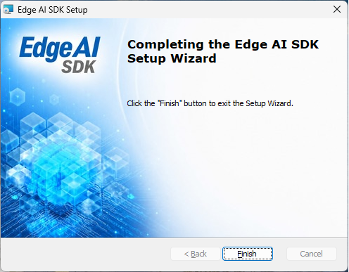

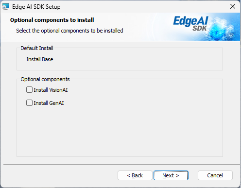

User Manual 3.x

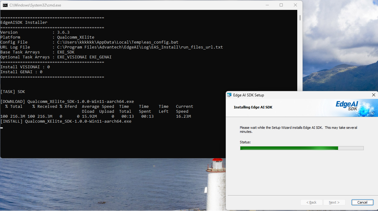

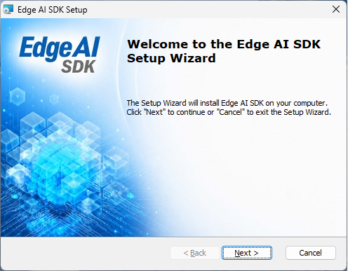

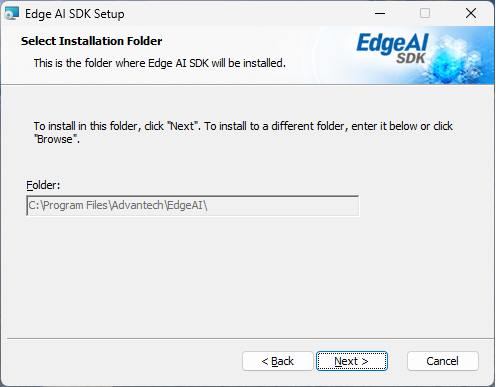

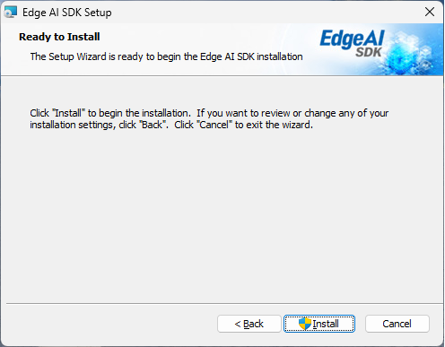

Install
Internet Connect (Required)
  • Go into Folder :
    C:\Program Files\Advantech\EdgeAI\Installer\script
  • Run Edge AI SDK Installer.bat
Windows install-1 Windows install-2 Windows install-2 Windows install-2 Windows install-2 Windows install-2

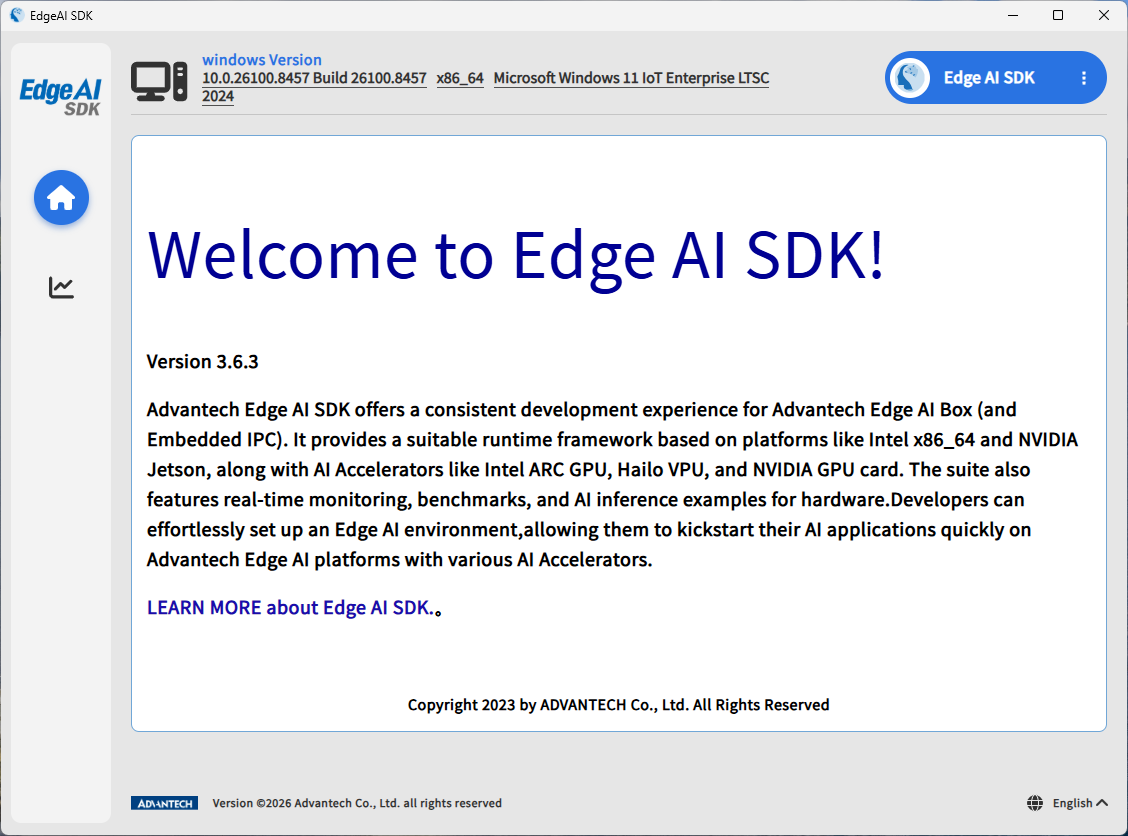

Edge AI SDK caters to users who are comfortable with the machine learning (ML) experience. It can quickly evaluate computing performance for the CPU, GPU, or NPU, and provides runtime results inferenced with ML.
Double click the icon (Edge AI SDK - shortcut) on the Desktop to start the Edge AI SDK App.
Desktop Shortcut
Then press the Agree button to proceed.
EUAL
Information
- Version
- Introduction of Edge AI SDK

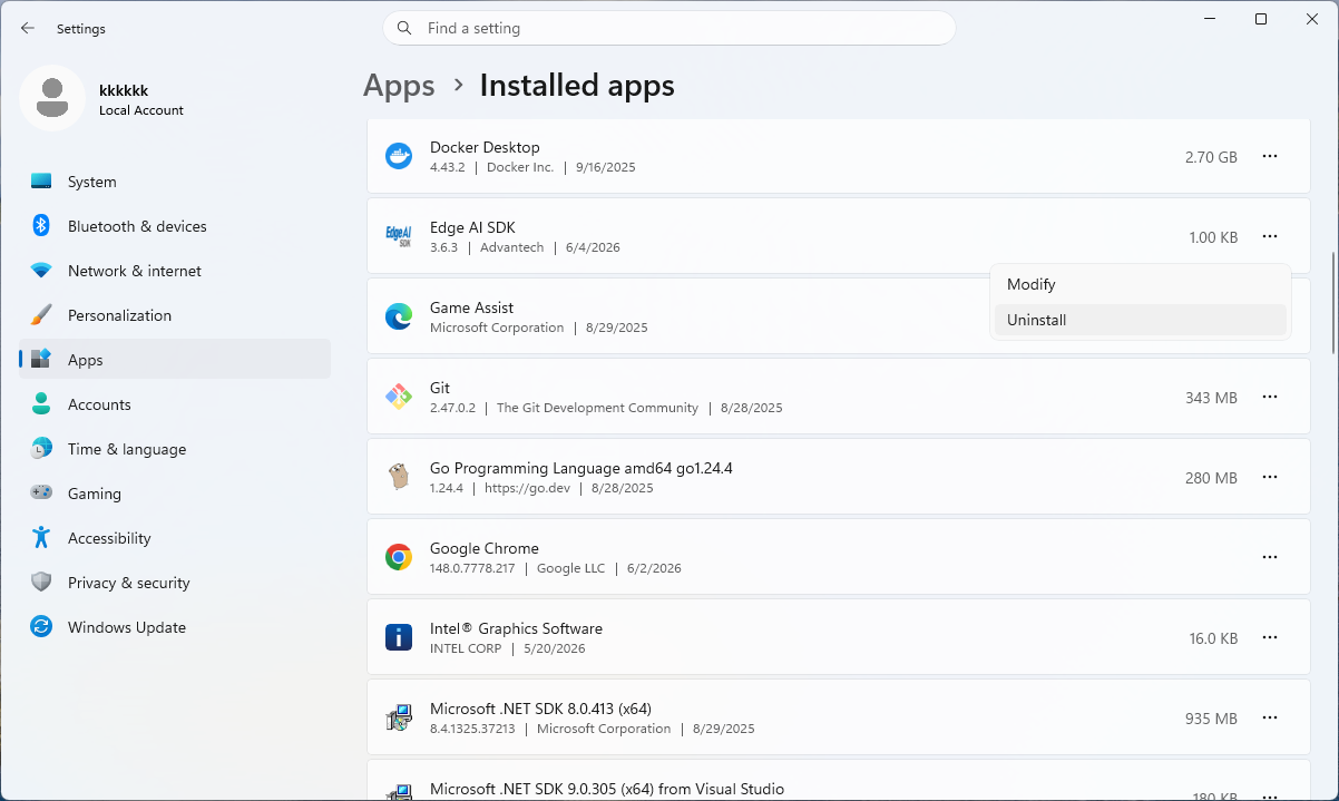

Uninstall
Windows uninstall-1
