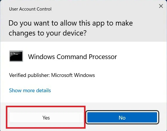

Uninstall
  1. cd "C:\Program Files\Advantech\EdgeAI"
  2. Run unInstall.bat
  3. Select Yes
    Windows Command Processor

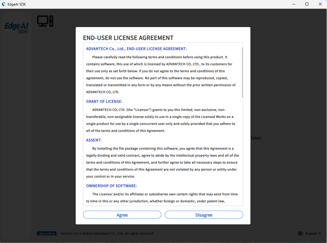

Double click the icon (Edge AI SDK - shortcut) on the Desktop to start the Edge AI SDK App.
Desktop Shortcut
Then press the Agree button to proceed.
EUAL

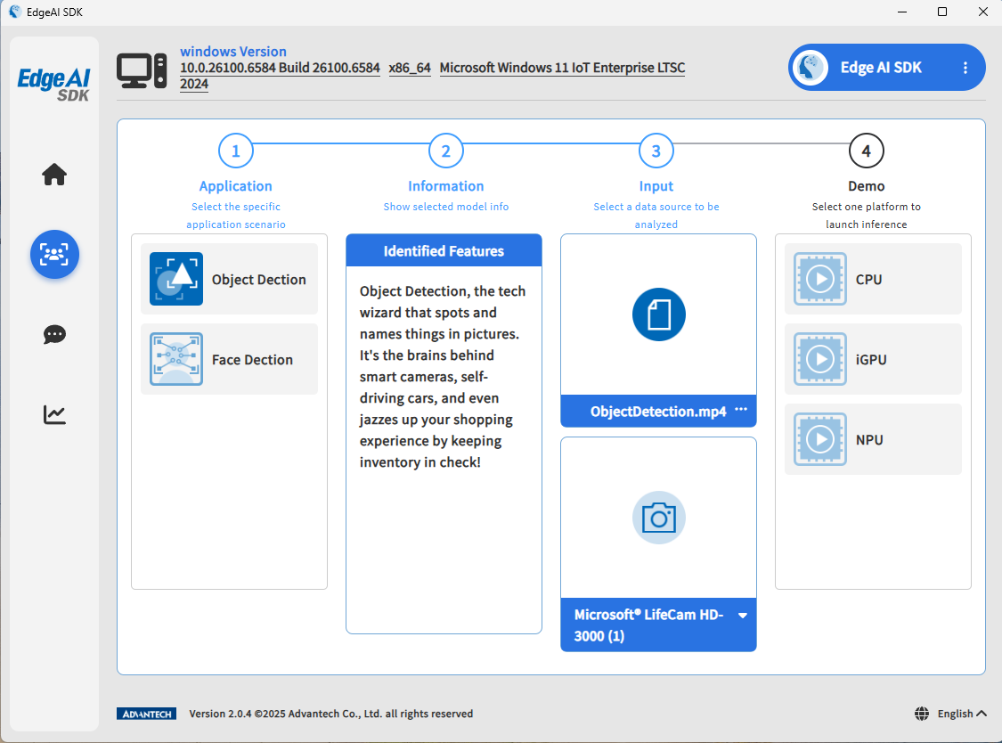

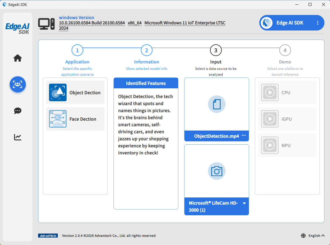

How to Quickly Start Vision AI

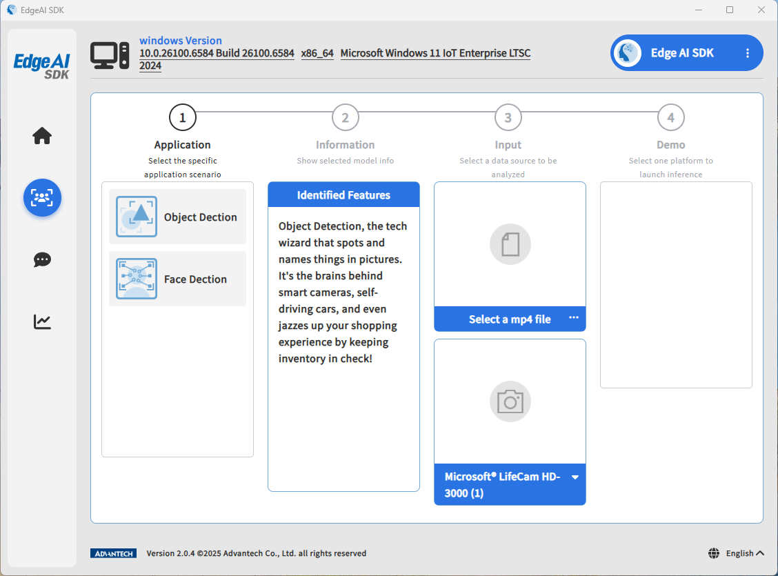

Step 1. Go to the “Quick Start (Vision AI)” page.
Vision AI Step 1
Step 2. Choose one application you want to activate and confirm inference info.
(1. Object detection, 2. Face detection)
Vision AI Object Detect
Step 3. Choose your video source which could be video clips or a USB Camera.
Video (Note: .MP4 only)
Media File
USB Camera
USB Camera

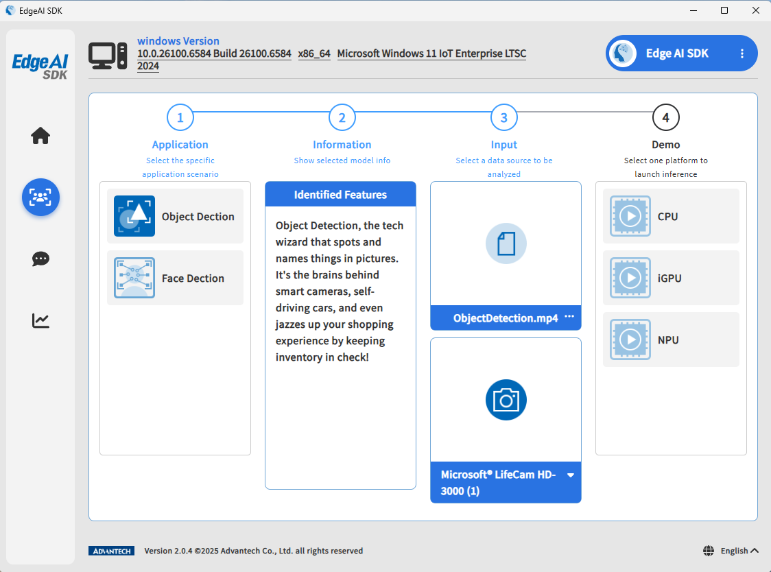

Step 4. Choose one of the acceleration chipsets to execute the selected inference application.
(Note: The available accelerator chipsets depend on your AI system and accelerator card.)
Device Select

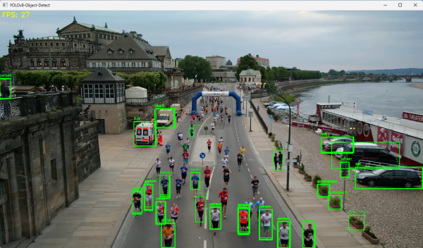

Step 5. Another window will pop up to show the AI inference.
Vision AI Result
Object Detection
Object Detection is a computer vision task in which the goal is to detect and locate objects of interest in an image or video.
Object Detection Result

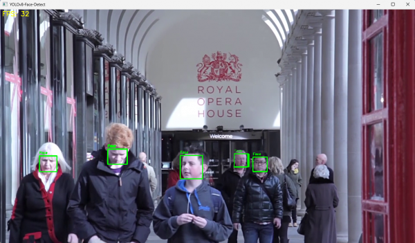

Face Detection
Face Detection is the task of making a positive identification of a face in a photo or video image against a pre-existing database of faces.
Face Detection Result

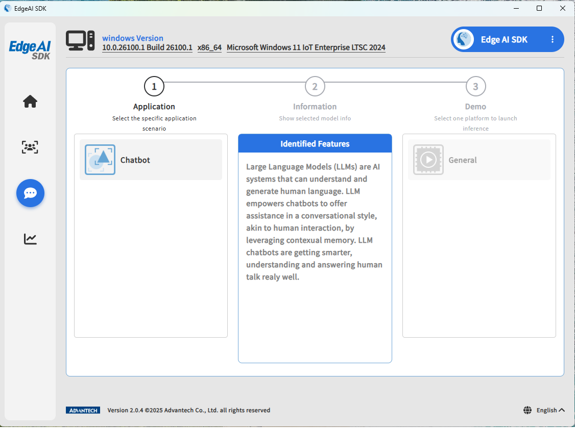

How to Quickly Start GenAI

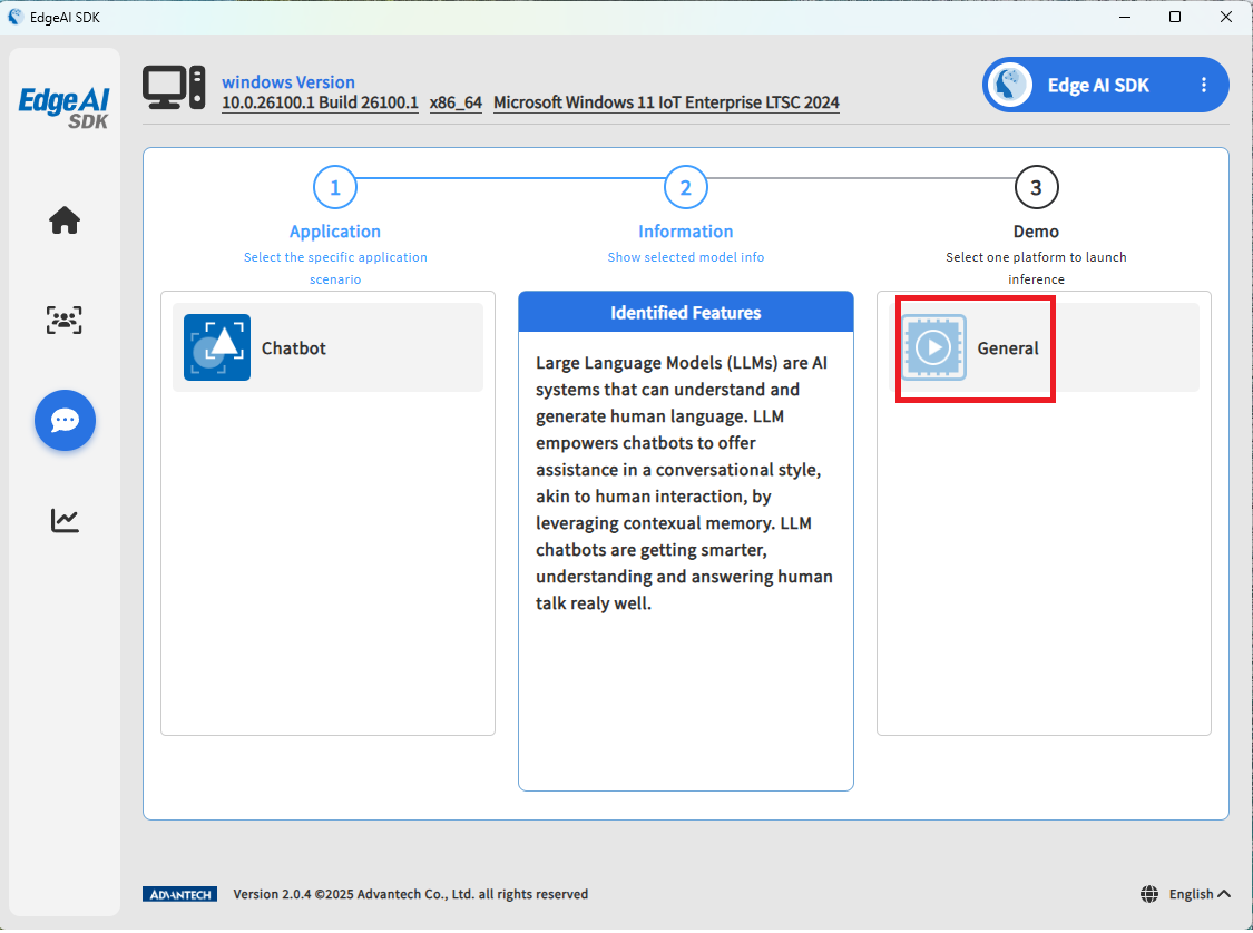

Step 1. Go to the “Quick Start (GenAI)” and choose the chatbot application page.
GenAI 1
Step 2. Choose General to execute the selected chatbot application.
GenAI 2

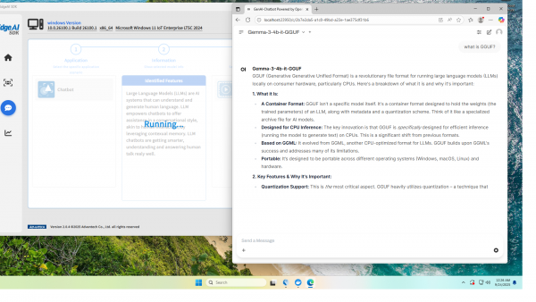

Step 3. Another window will pop up to show the chatbot.
GenAI 3

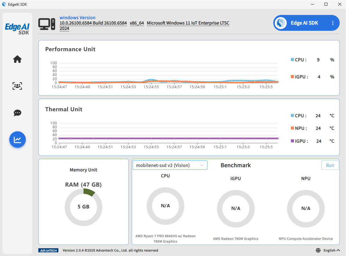

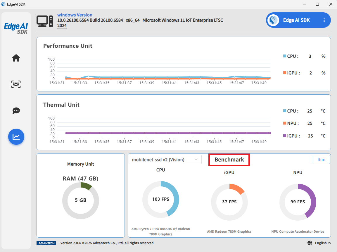

Monitor AI System Performance
Go to the “System Monitoring” page. This page shows payload and temperature for each chipset.
System Monitor
Evaluate the Benchmark Performance
Go to the “System Monitoring” page and select Vision.
Click the Run button to evaluate each chipset performance and wait for a few seconds to get FPS results.
System Monitor Benchmark
