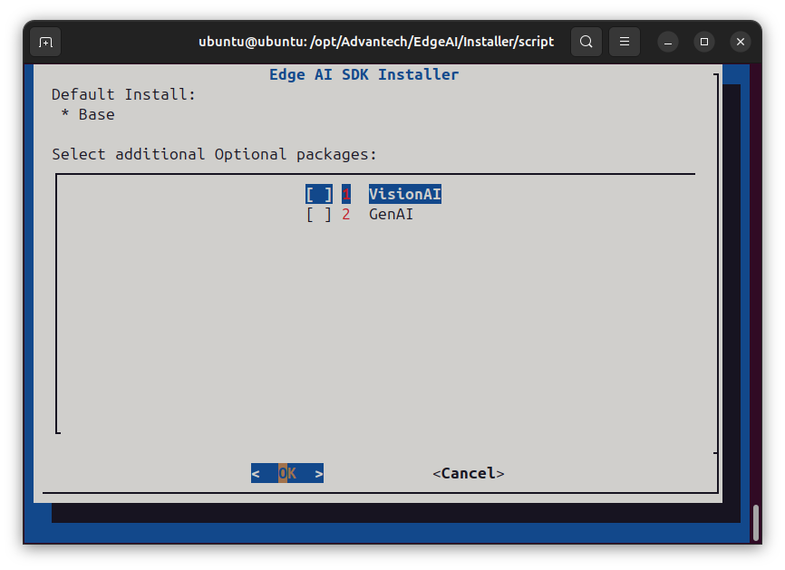

Install

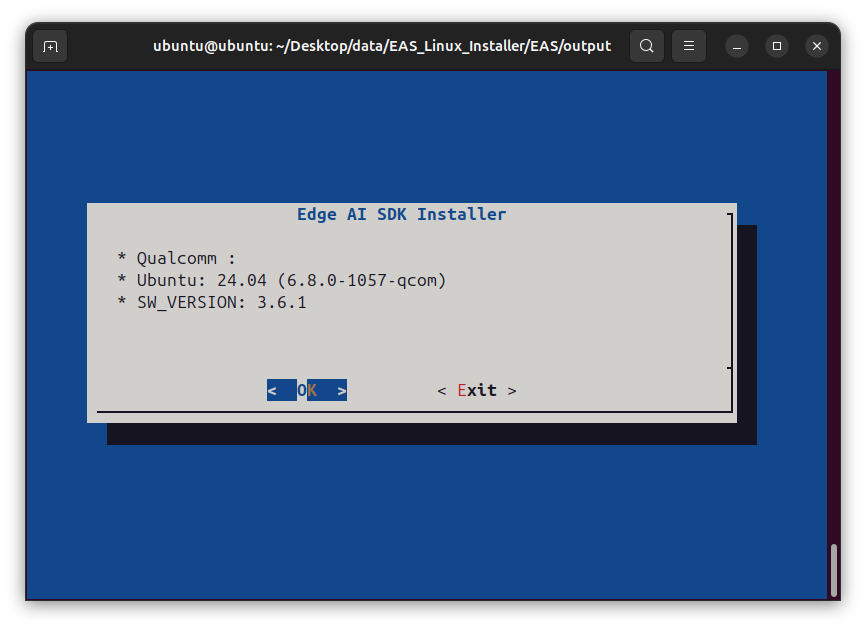

Internet Connect (Required)

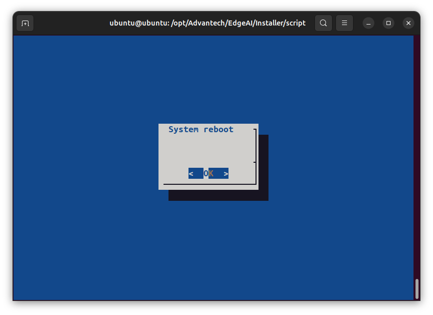

cd /opt/Advantech/EdgeAI/Installer/script
./exec_install.sh
  • System Information (by target platform)
  • Select AI SDK
  • Install Complete

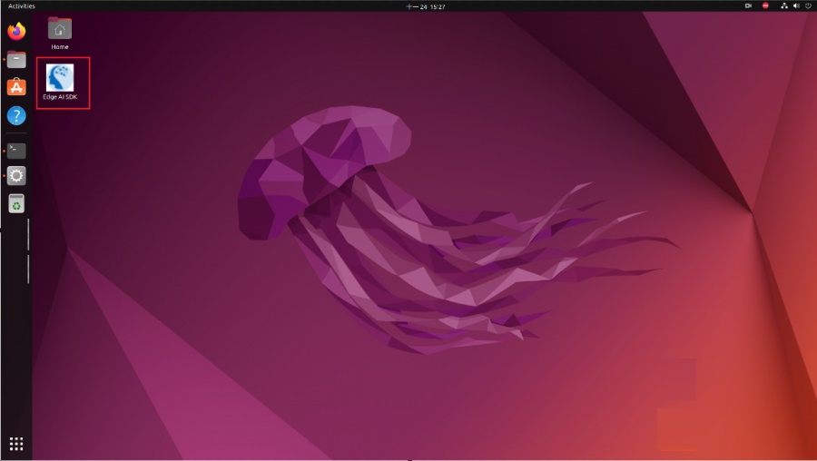

Double click the icon (in the red box) on the Desktop to start the Edge AI SDK App.

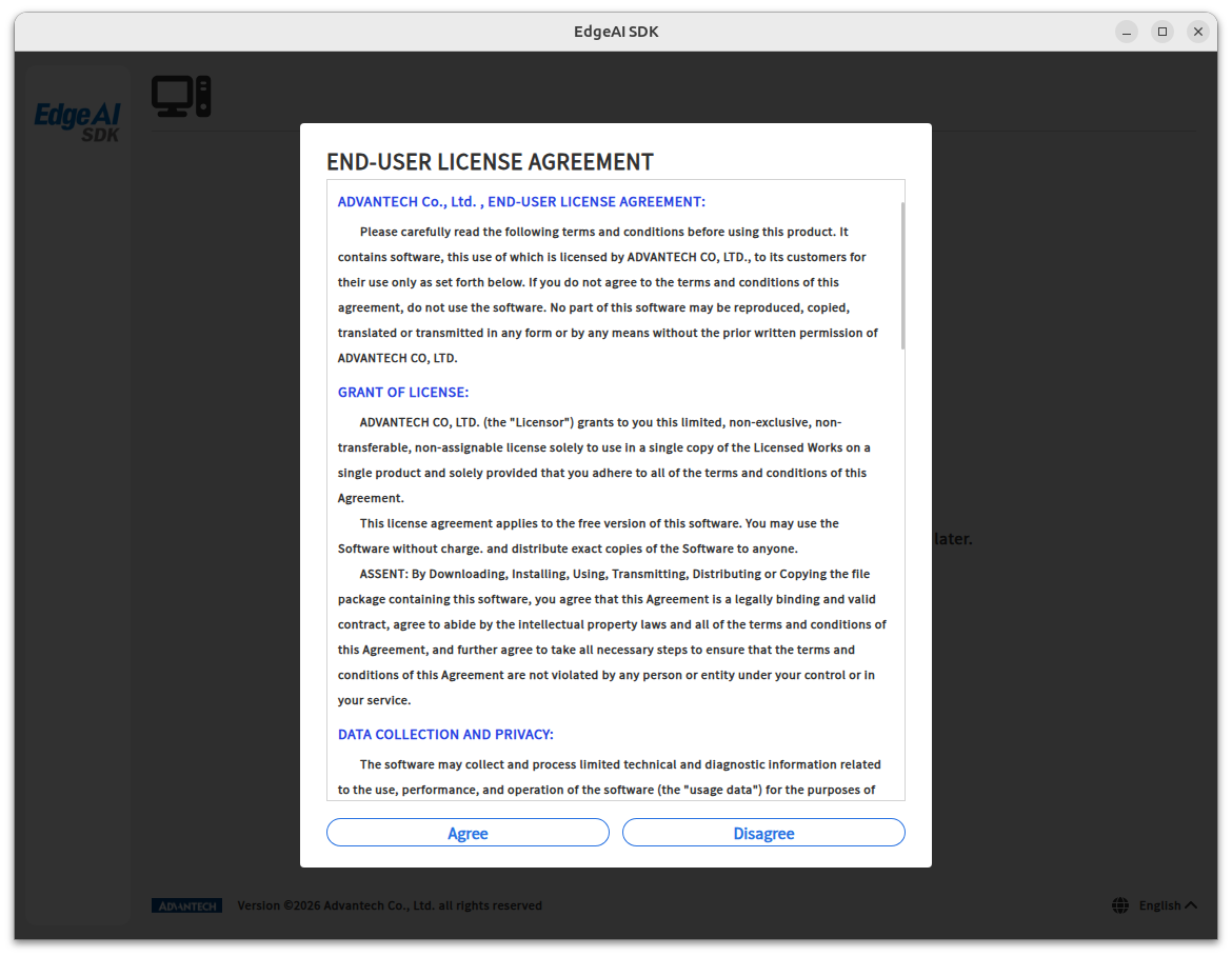

Activation
  • License Agreement
    Please review EULA and then press the Activation button if the content is agreed.

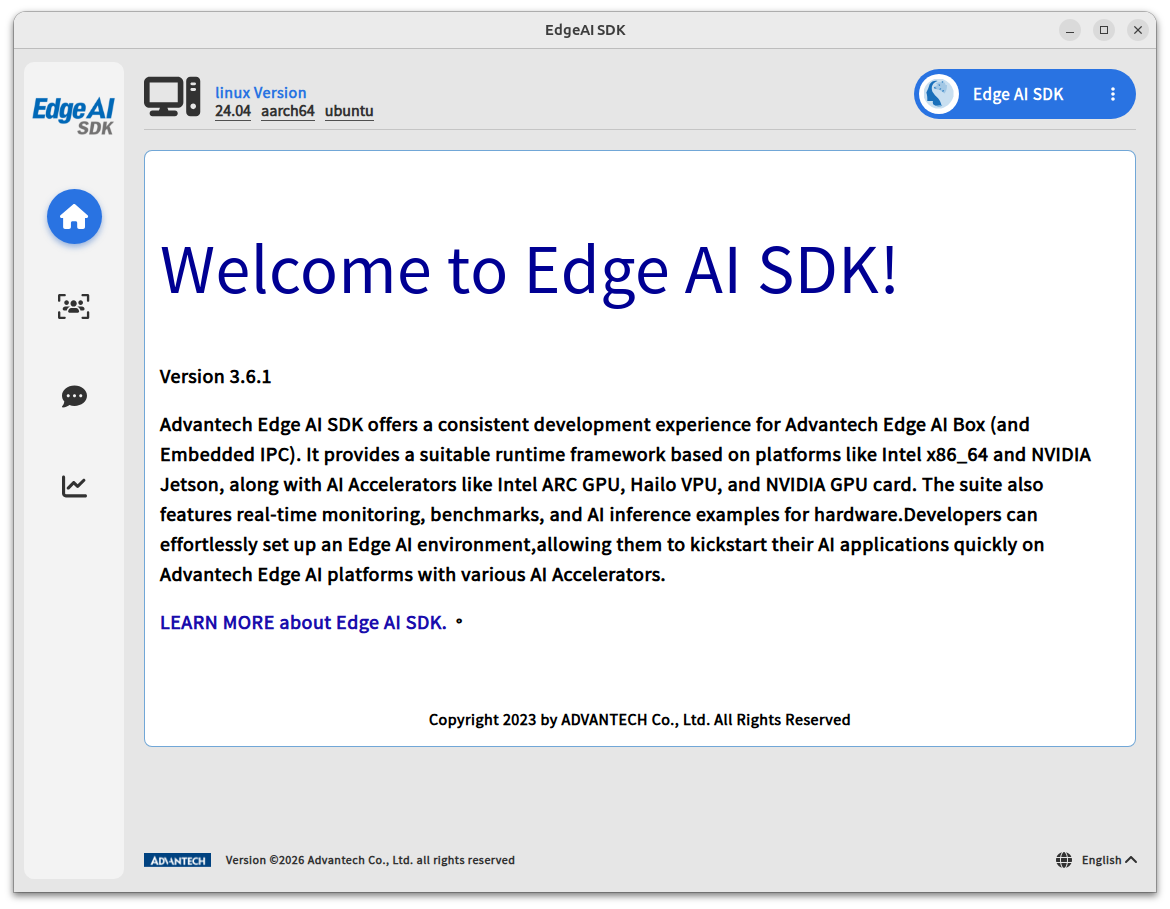

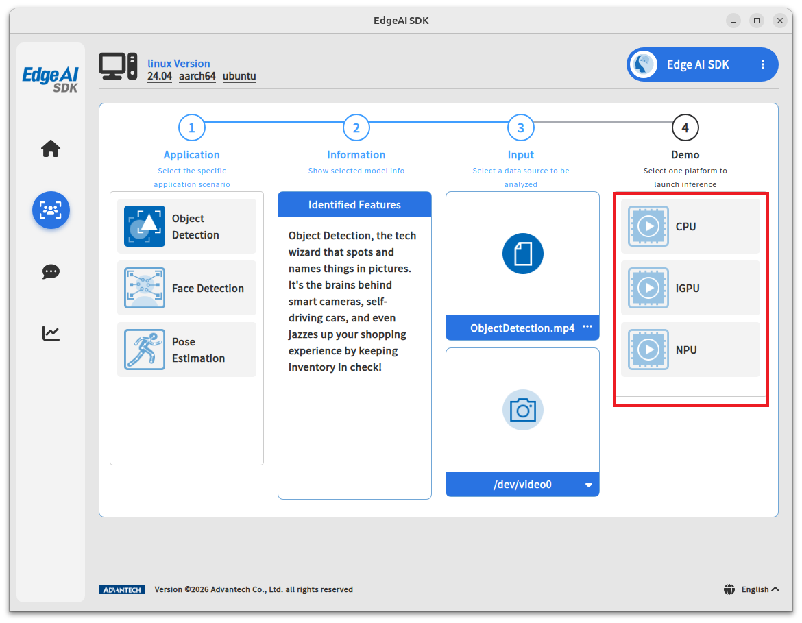

Step 1. Go to the Quick Start (Welcome) page, as shown below.

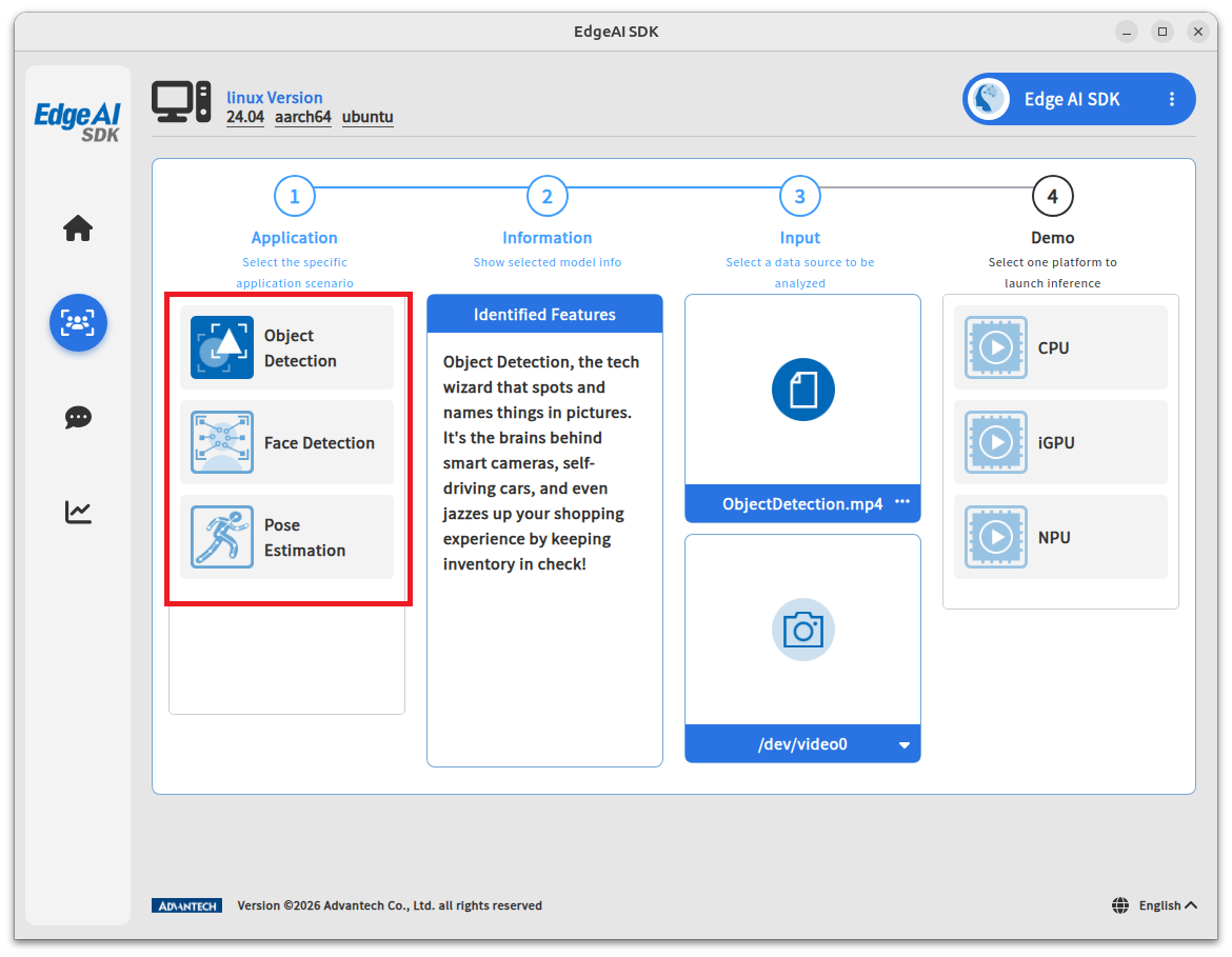

How to Quickly Start Vision AI

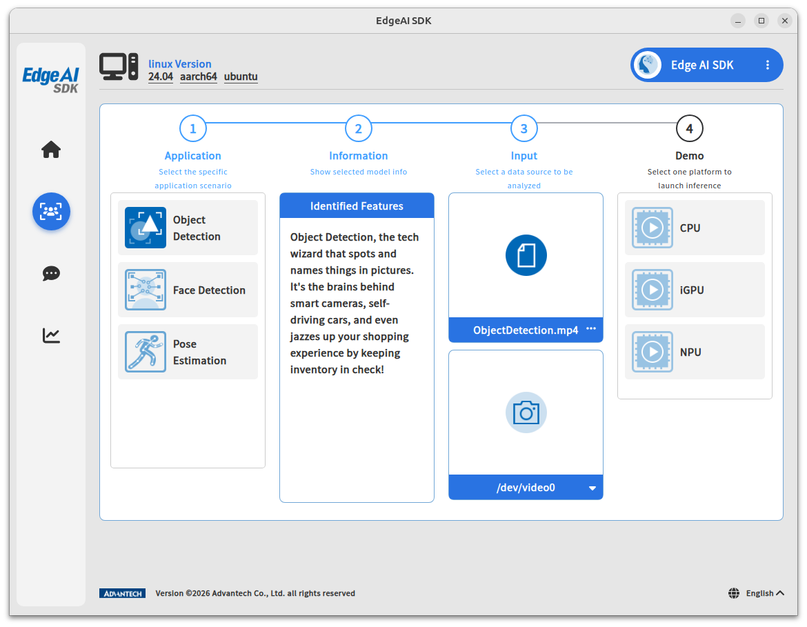

Step 1. Go to the Quick Start (Vision) page, as shown below.
Step 2. Choose one application you want to activate and confirm inference info.
(1. Object detection, 2. Face detection, 3. Person detection, 4. Pose estimation)

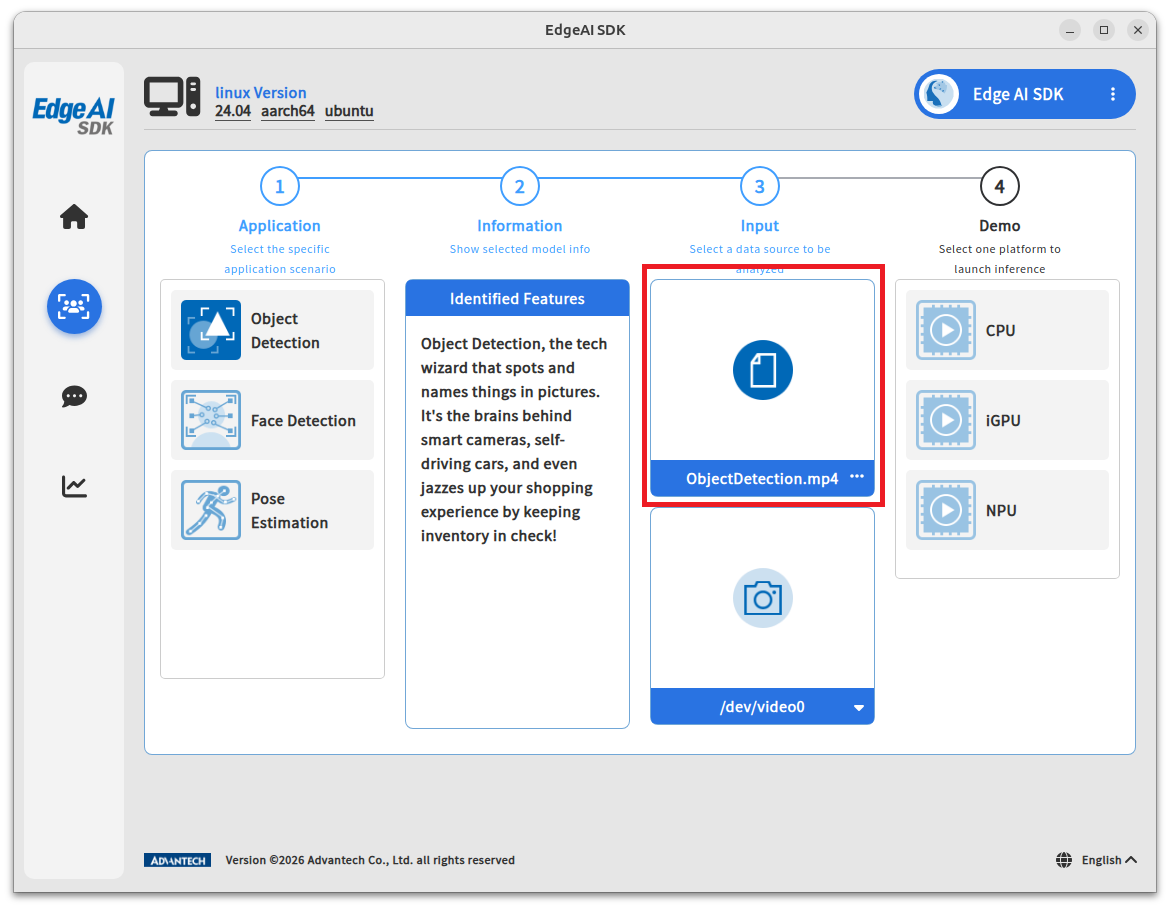

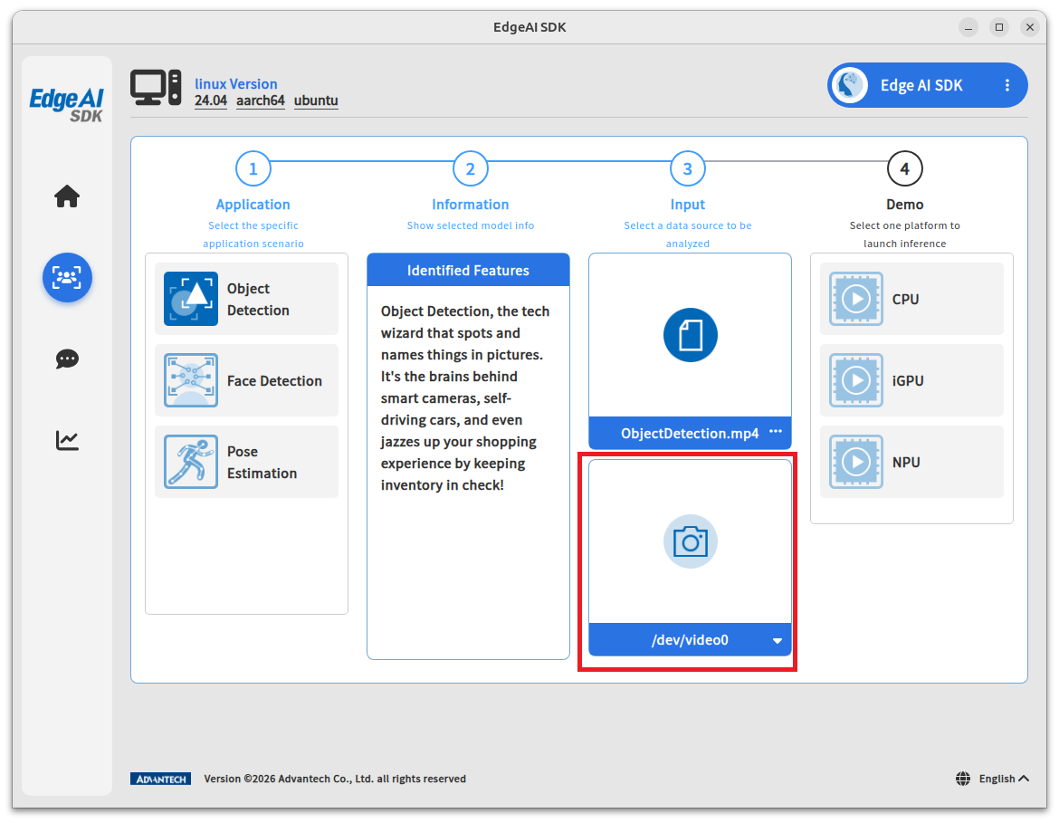

Step 3. Choose your video source (video clips or USB Camera).
  • Video (Note: .MP4 only)
  • USB Camera
Step 4. Choose one of the acceleration chipsets to execute the selected inference application.
Note: The available accelerator chipsets depend on your AI system and accelerator card.

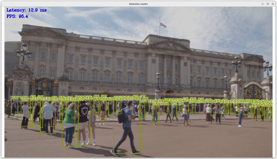

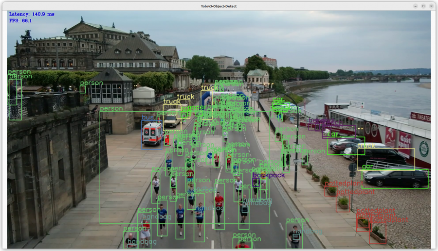

Step 5. Another window will pop up to show the AI inference.
Object Detection
Object Detection is a computer vision task in which the goal is to detect and locate objects of interest in an image or video.
It involves identifying the position and boundaries of objects, and classifying them into different categories.

Person Detection
Person Detection is based on object detection systems that can classify detected objects as human.
It is used in many sectors: security, insurance, nursing, health, and production.

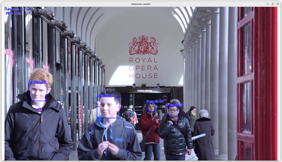

Face Detection
Facial Detection is the task of identifying faces in a photo or video against a database.
It begins with detection (distinguishing faces) and continues with identification.

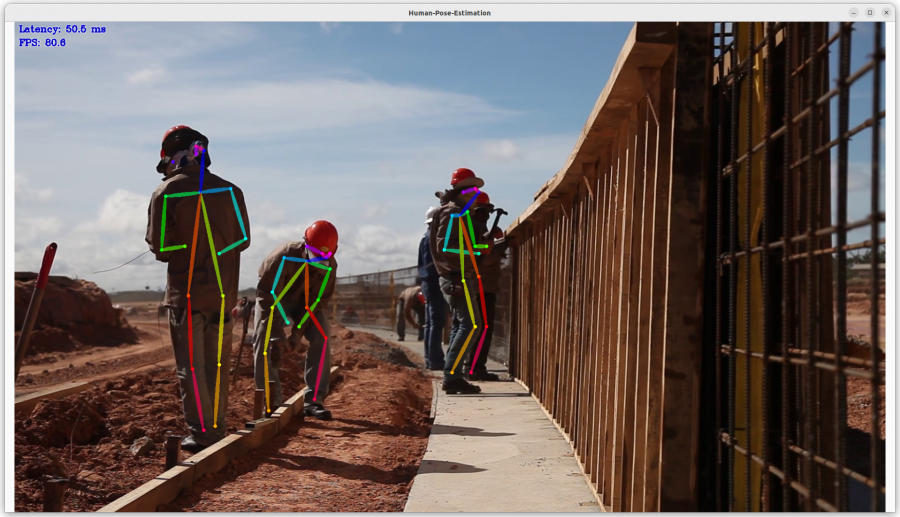

Pose Estimation
Pose Estimation detects the position and orientation of a person or object.
Usually done by predicting keypoints like hands, head, elbows, etc.

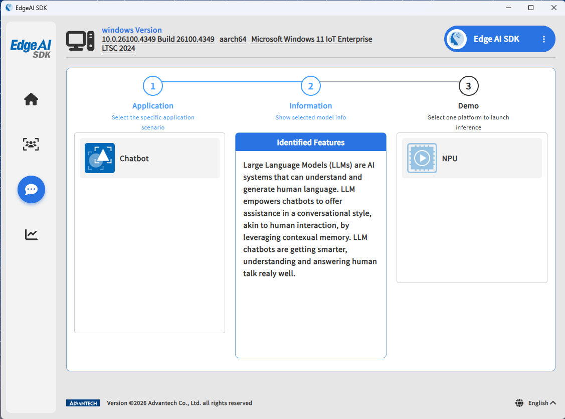

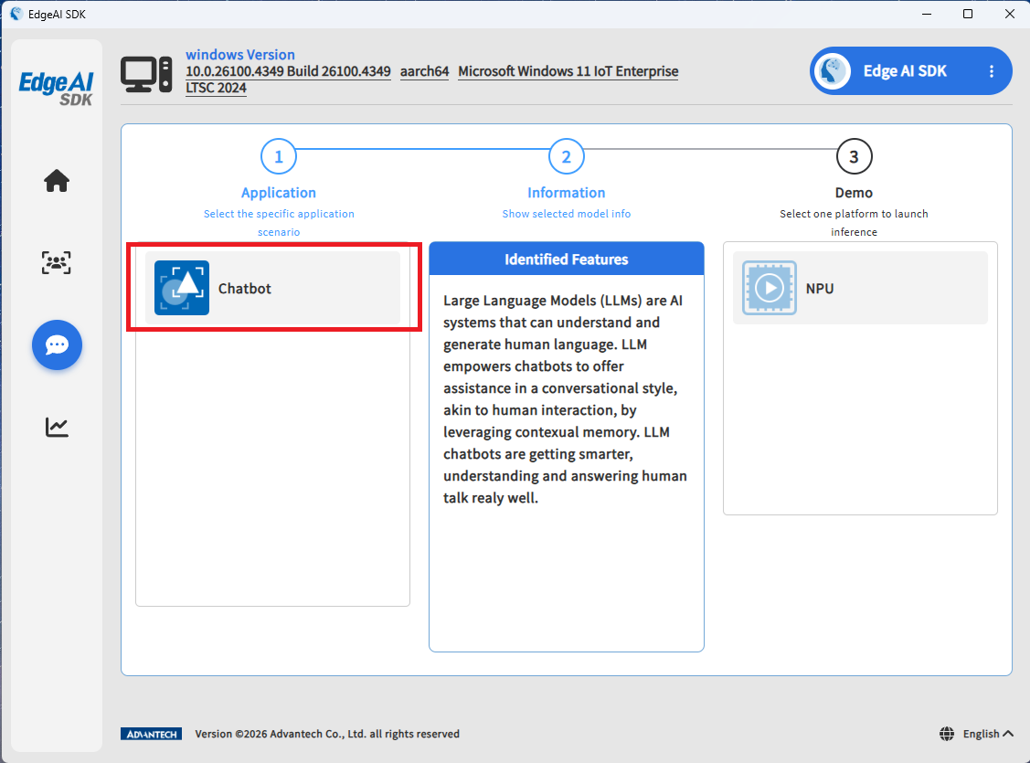

How to Quickly Start GenAI
Step 1. Go to the Quick Start (GenAI) page.
Step 2. Choose application (chatbot).

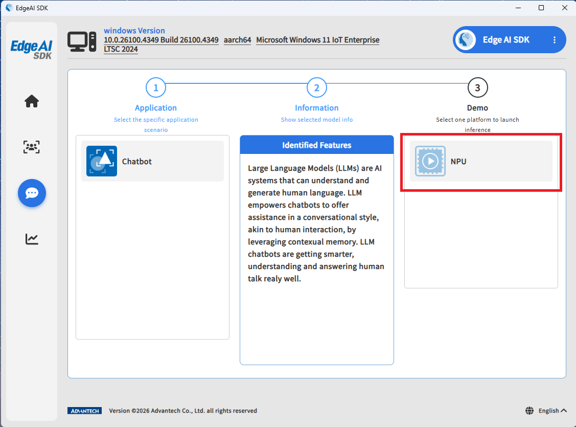

Step 3. Choose one of the acceleration chipsets.

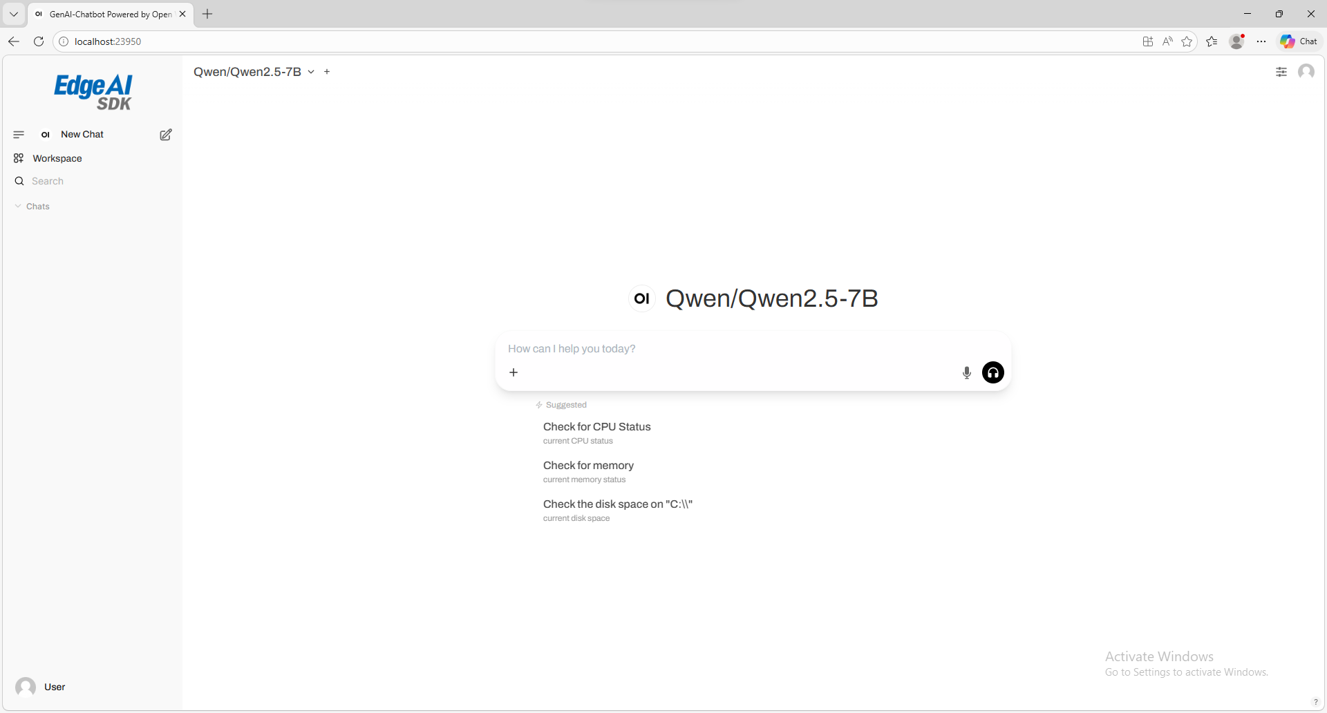

Step 4. Another window will pop up to show the chatbot.

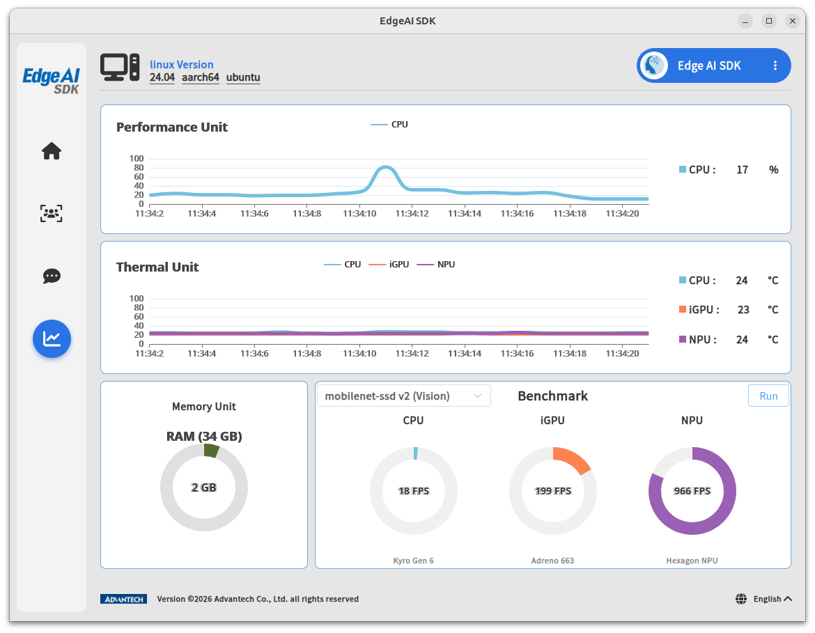

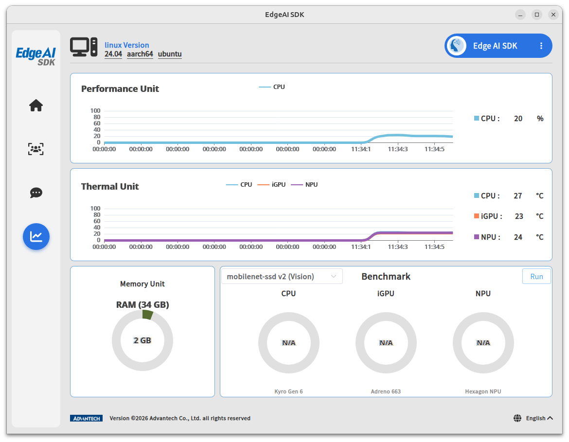

Monitor AI System Performance
Go to the System Monitoring page.
This page shows payload and temperature for each chipset.
Evaluate the Benchmark Performance
  • Go to System Monitoring → Vision, click Run to evaluate chipset performance.
    FPS results will show after a few seconds.
