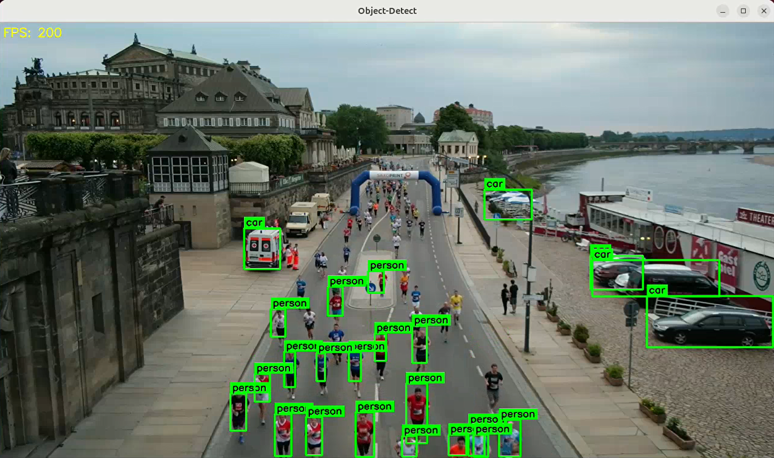

Application
VisionAI
AIR-055
Application (FPS) CPU iGPU NPU Note Object Detection 10 40 200 YOLOv11n-w8a16 Face Detection 12 20 55 Lightweight-Face-Detection-w8a8 Pose Estimation 1 4 18 YOLOv11n-w8a16 +HRNetPose-w8a8 -VisionAI_GUI-a073e01c3de811d7a8085d06e9af4e76.png)

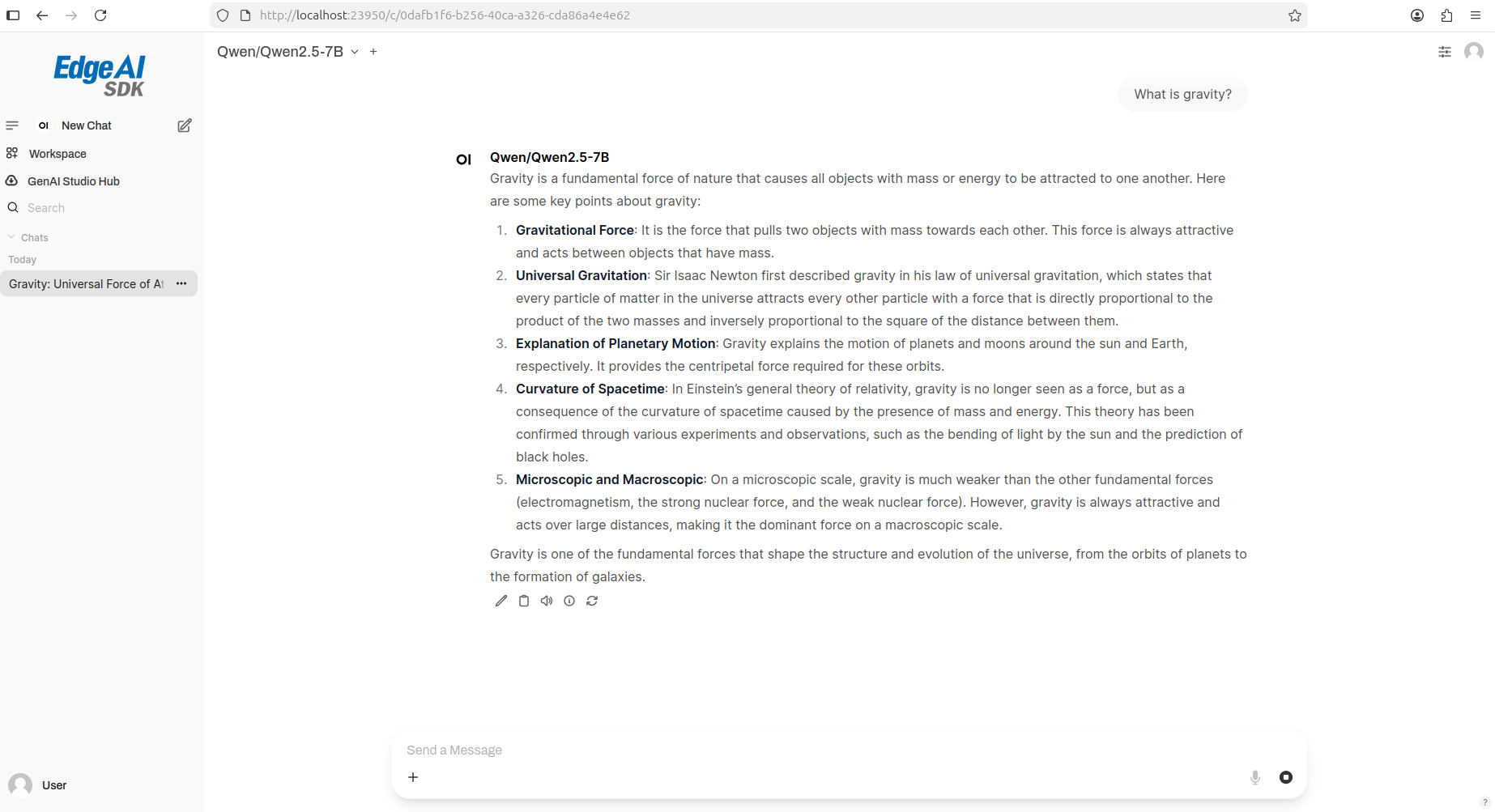

Generative AI
GenAI Chatbot
Platform Version Model TTFT (s) TPS (tokens/s) Note AIR-055 v3.6.1 Qwen2.5-7B-Instruct 3 7 Only this model is supported -GenAI-5436e64eb5d9ccabc785d74baa217b4c.png)

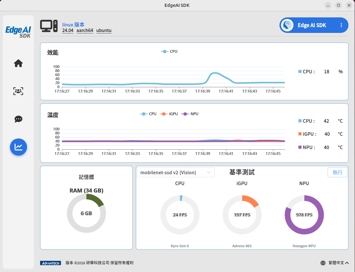

Benchmark
It can quickly evaluate computing performance for the NPU, and provides runtime results inferenced with ML.
-Benchmark-GUI-79d15acd8f4bad87bc932afc1e287b7a.png)
- Run on NPU ( Terminal )
QAIRT_ROOT="/opt/qcom/aistack/qairt/2.41.0.251128/lib" ADSP_LIBRARY_PATH="/opt/qcom/aistack/qairt/2.41.0.251128/lib/hexagon-v73/unsigned" LD_LIBRARY_PATH="/opt/qcom/aistack/qairt/2.41.0.251128/lib/aarch64-oe-linux-gcc11.2:$LD_LIBRARY_PATH" PATH="/opt/qcom/aistack/qairt/2.41.0.251128/lib/aarch64-oe-linux-gcc11.2:$PATH" /opt/Advantech/EdgeAI/System/Qualcomm_IQ9/SDK/benchmark/snpe-throughput-net-run --duration 1 --perf_profile burst --use_dsp --userbuffer_auto --container /opt/Advantech/EdgeAI/System/Qualcomm_IQ9/SDK/benchmark/mobilenet_v2-mobilenet-v2-w8a16.dlc

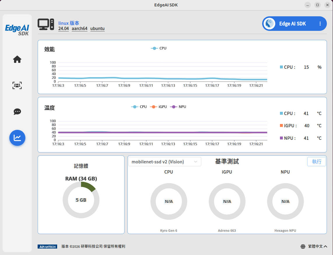

System Monitoring
-SystemMonitoring-GUI-a25d0251fa73317bdaa2ea6bb615e556.png)
