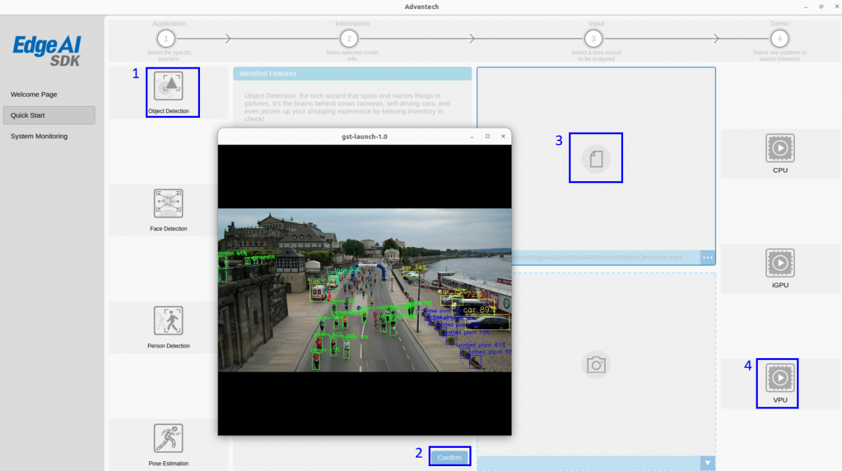

Edge AI SDK / Application​
Quick Start / Application / Video or WebCam / VPU
ObjectDetection
ApplicationModelFPS (EAS-1200 for 1 chipset)FPS (EAS-3300 for 2 chipset)
Object Detectionyolov8m.hef32118
Person Detectionyolov5s_personface_reid.hef / repvgg_a0_person_reid_2048.hef167276
Face Detectionscrfd_10g.hef / arcface_mobilefacenet_v1.hef78157
Pose Estimationcenterpose_regnetx_1.6gf_fpn.hef46143

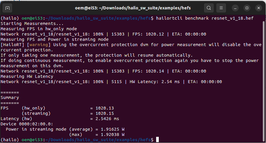

Benchmark​
In order to measure FPS, power and latency of the Hailo Model Zoo networks you can use the HailoRT command line interface. For more information please refer to the HailoRT documentation in link.
Hailo-8 Benchmark​
Run benchmark:
docker run --rm --privileged --network host --name adv_hailo --ipc=host --device /dev/dri:/dev/dri -v /tmp/hailo_docker.xauth:/home/hailo/.Xauthority -v /tmp/.X11-unix/:/tmp/.X11-unix/ -v /dev:/dev -v /lib/firmware:/lib/firmware --group-add 44 -e DISPLAY=$DISPLAY -e XDG_RUNTIME_DIR=$XDG_RUNTIME_DIR -e hailort_enable_service=yes -it advigw/eas-x86-hailo8:ubuntu22.04-1.0.0 /bin/bash
hailortcli benchmark <hailo_model.hef>

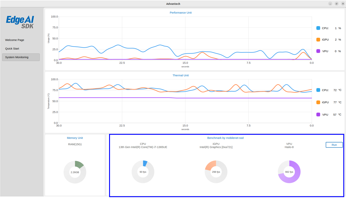

benchmark
Edge AI SDK / Benchmark​
Evaluate the Hailo-8 performance with Edge AI SDK.
Benchmark

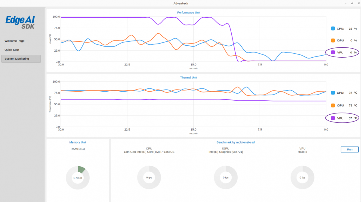

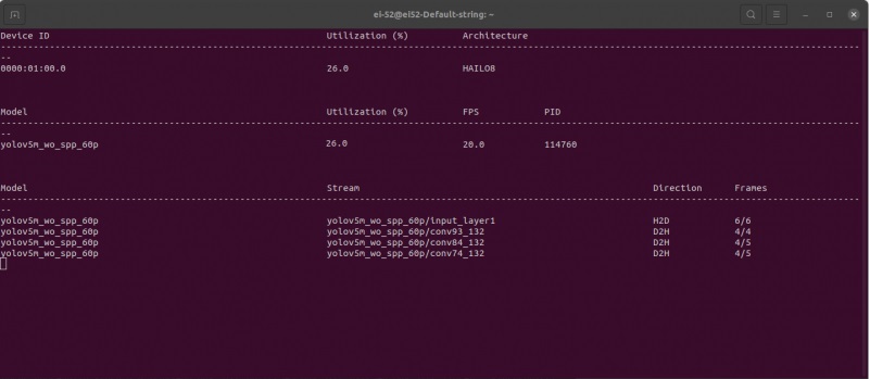

Hailo-8 Utilization​
export HAILO_MONITOR=1
hailortcli monitor
Hailo VPU Usage

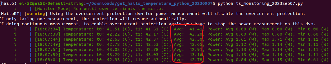

Hailo-8 Temperature​
python ts_monitoring_2023Sep07.py
Thermal in hailortcli
Edge AI SDK / Monitoring​
thermal
