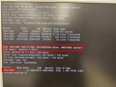

  • Step 2: Mount the USB
Enter "fdisk -l" to find the location of the USB drive.
Intel Patch
For example, the usb storage location is /dev/sdb1 (as shown in the second red box in the image).
Enter the following commands to mount the USB:
$ fdisk -l        # find USB location (e.g., /dev/sdb1)
$ mkdir /mnt/usb
$ mount /dev/sdb1 /mnt/usb/
$ cd /mnt/usb
